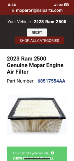

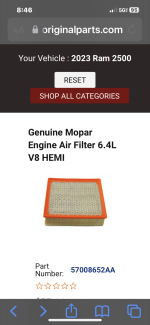

I’m seeing two filter options, both state they are compatible and OEM. The black liner one is $48 and the orange lined one is $55 any suggestions and are those prices reasonable or can I do better on another site?

I believe the orange one is the one you want. Pretty sure the 685 is for the cummins.

Either filter can fit the 19+ Hemi, but the 68517554AA is for 07.5-18 6.7L Cummins or 19+ Hemi's. The AB filter (orange) is good for all 6.7 engines and years.
You may be correct but everything I've read says not to use the black filter in 2019+. The orange came from factory in the 2019+, haven't read anything saying it's okay in pre 2019+
The orange (AB) has been used in the 6.7 since 2007, and is still the current factory filter. It’s suppposed to be used in the 19+ 6.7’s.
The white (AA) filter was released a couple years ago and was supposed to superceede the AB filter, but the 19+ 6.7’s don’t like it. 19+ Hemi’s are supposed to use the AA filter per Ram. Pre 19 6.7’s are also recommended to use the AA filter, but either AA or AB will work.
