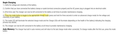

Which is it? I just checked by unplugging the NOCO and plugging it back in a few minutes later and it came back set as AGM...
I think I may not have even switched it last time I plugged the cord in so it must be remembering the setting afterall.
well, I should dig deeper before going off the deep end.
NOCO says it has "auto memory" so the one time I saw it not return to AGM must have been a fluke.

My 10 amp NOCO is under the hood and the few times I have chedked it, it is sitting on the setting last used which in my case is AGM. I had to set it to AGM the first time I used it since it does not automatically recognize the battery type when first connected. Set it and forget it. And yes, I like to charge to the correct AGM voltage once in a while to prolong the AGM battery life since the trucks charging system is designed for normal lead acid batteries at slightly lower voltage.

Same charger I use. There is no mention of auto-detecting battery chemistry in the manual, it actually tells you to manually select the chemistry.
I use it in multiple batteries with different chemistry and always have to select the proper mode, same as my Genius 1.
The auto-memory feature also negates the auto-detection ability.
Well I decided to test the auto battery detect type by hooking mine up to one of the lithium batteries I have. It did not automatically detect the type and I had to select lithium. So I guess that puts to rest that part of the internet claims.

The fact all their current docs state Auto-Memory runs contrary to any auto detection.
