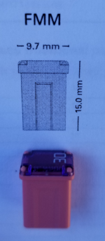

Still a work in progress as I haven't had time to revisit, but for the trailer fuse, here' s the detail.
These ARE M-case fuses, but I prefer the Bussman style "FMM"
F3030 Amp PinkMCASE(FMM)/Trailer Tow Receptacle / Trailer Tow (Separate E-Brake)/Trailer Tow (BUX)
GenericBussman
A - Micro 2.
B - Micro 3.
C - Maxi.
D - Mini.
E - M Case.FMM
F - J Case.
G - J Case Low Profile.FMX
H - Slotted M Case.
Well IT was the fuse located at #30. Previous owner might of blew or im actually wondering how it did blow. Went to wally world for the fuse....no luck. Then oriely. Got pink 30 that I THOUGHT was the correct size.....turns out it wasn't. This one is slightly bigger. WHY DIDNT I BRING IT WITH ME TO THE STORE.....I wish I knew lol. Well was bummed when I found out wrong size. I got 1 hour until dealership closes. BUT BUT BUT then I LOOK thoroughly at fuse box to find out there is an EXTRA fuse located top left corner of fuse box. In business now. Wanted to let all know the update as well as the fact there are extra fuses in the fusebox....maybe save someone the trouble.
