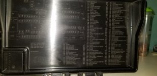

No 12v power on 7 way Trailer Plug Wiring Connector. Need Help

@MCV did you buy the truck new? Maybe a previous owner modified the 7 pin wiring? Either way you won’t get any charge from your truck with the engine off, you must have the engine running to get the voltage high enough to charge the trailer.
My thought exactly, at most you will just drain your truck batteries but it wont produce a “charge”
