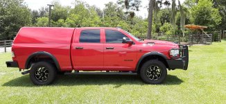

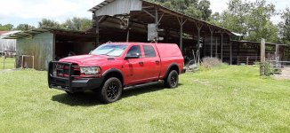

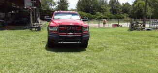

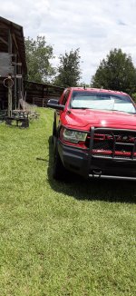

Well I decided to get my tires mounted on my new wheels and then Install them at home.
I had purchased an new tackoff set of 2020 Laramie lImited Wheels and tires but since I am going to larger wheels and tires these came off and I will sell those only had 1500 miles on them.

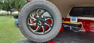

I went with an Ultra (made in the USA) wheel "villan" new for 2020 its a 20x9 +18 specifically for the leveling kit I am going with next week, I have Nitto Terra Grapplers 35x12.50 20's.
Since I added the 2019 Ram Power Wagon fender flares the tires fit perfect right on the edge of the fender flare which is the look I wanted.
Added new TPMS , they do not rub at all but I am not concerned since next week I will install the Carli Leveling 2.5 kit with the track bar and stabilzer shock.
Also purchased all of the Mopar Black emblems , hood, Cummins, RAM, and 4x4 they look good on the red truck.
