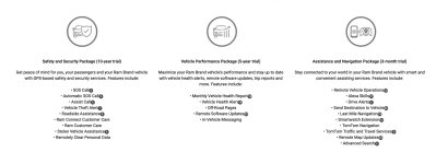

Just adding this here, the list of what is supposed to be included in the 5 year and 10 year free trials.
