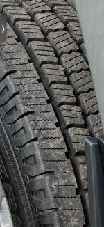

A problem I have with a lot of the suggested tires is the lazy siping. The cuts often dont go all the way down to the ware lines, meaning youll loose their benefit before the tire is ready to change out. And if the siping is there, its all of one zig zag line per tread block.
My new to me 2500 has cooper discover ht3 on it. Not my first choice but they have a ton of tread left so im going to give them a chance. But for comparison you can see the difference in the quality of the siping between the two.
Coopers
Bridgestones
