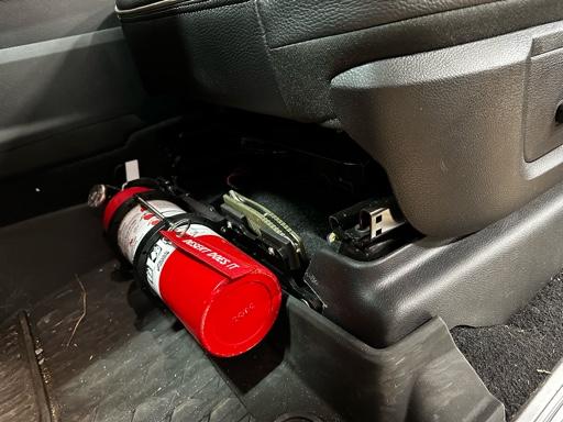

I’m not part of the recall but usually have at least one extinguisher in all my vehicles. Good to have. In the 3500 I have one mounted under the drivers seat using a Desert Does It Mount. Expensive but works well (you do have to trim some plastic though).
