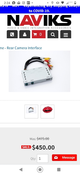

Spoke with Naviks rep today, to just add two cameras in the bed to see my GN hitch, I need to order the attached. But I don't see paying $450 plus the cameras just to have them... I would rather buy the system talked about in this thread and have the additional functions.

If you have the 5 camera surround 12 inch screen system in your 2019+ HD Ram truck you do NOT need that product. IF you are willing to invest in what it takes to activate the RCA jacks that come with the Naviks unit decsribed here. Without the optional RAm trailer camera wiring you don't have any way to view those RCA inputs. Just two pages back in this thread TXsportdiver explains what it takes to accomplish what you want to do with the Naviks unit we all have.
