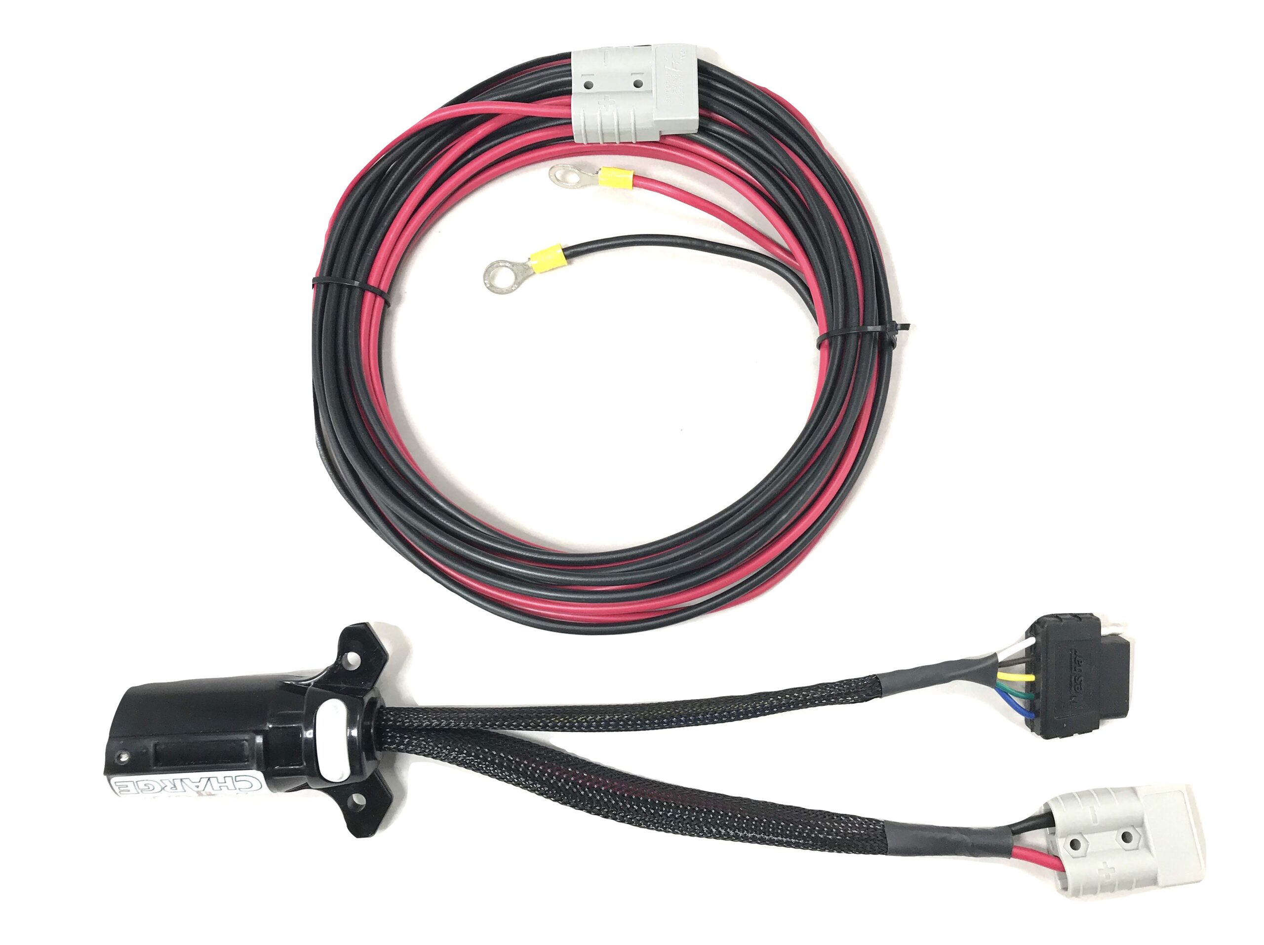

While poking around on the forums here, I saw someone (I can't remember where) mention the Curt 7-pin harness adaptor as an option. So, I picked one up on Amazon for about $26. (Side note- EZTopperLift sells a similar solution that comes with some nice wiring already set up including a detachable plug for $110. They call it the "Stow-in-charge" and it looks like a nice setup, but I didn't see the need to pay for their wiring connection.

-Curt 7 pin replacement harness

The first step was to figure out the wiring on the 7-pin harness. It was a lot less intuitive than I would have expected, and for some reason, there seemed to be a bunch of different wiring setups depending on which version of 7-pin you have. But, after a little research, and some trial and error on the 7-pin outlet at the bumper, I was able to determine which version I had, and which wire was which.
Contrary to what I would have expected, the 12v hot is black, and the 12v ground is white. I don't need the rest of the wires, (Turn signals, brakes, taillights, etc) so I wrapped them up nicely and tucked them out of the way.
