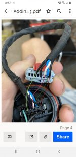

Hi again, one more question if its ok, is the 9 and 10 pins you talked about here the number of pins for the bsm custom harness inside the led tail lights left and right. I followed the instructions I found for the 1500 that showed the same pin count and connections for left and right, is this correct for the 2500 hd?
Okay, I give up. I finally got my BSM taillight assemblies for my 2021 2500 Laramie. Now, I cannot, for the life of me, figure out how to unplug / plug the new taillight wiring harness (6839 6013 AB) from the chassis harness - the end with the translucent locking tab. I have pushed and pulled the tab but to no avail. Any help would be greatly appreciated
Use a little screwdriver to pop the white tab out, then squeeze the black tab and pull
There is a little black tab on the wire end of the plug, squeeze it and the connector should come apart
I figured it out while I was under the truck - Hint: Do not try to figure it out on a new cable that has never been plugged in.
Thanks
