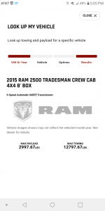

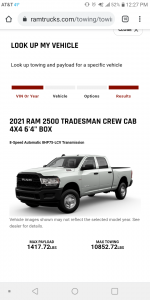

For instance. A TRADESMAN with Powerwagon package on top and my truck on the bottom
Powerwagon GVWR is 8565 and GCWR is 18000
My truck GVWR is 10000 and GCWR is 19800
Powerwagon 8565 minus 1417 is a base weight of 7148
My truck 10000 minus 2998 is base weight of 7002
Powerwagon 18000 minus 7148 is 10852
My truck 19800 minus 7002 is 12798
Can you see it now.
That 12798 is with a driverless truck and no hitch.
So my truck can not tow a 12798 pound trailer.
I hope this makes sense. If not...i can pull out my crayons. :p
This is why you need rain boots and an umbrella at the 5th Gen 1500 site. They see this max tow number...think it is max trailer and bam they are on wondering why their truck sags so much and won't stop coming down the mountain.
Can you see it now.
Us HeftyDuty guys are a bit better off as we do have more extra capacity.
Good times.
One must really pay attention to what they are believing

Why does that 21 have such a low payload? Same motor and config as mine but my ‘19 has almost 3200# payload
It is a tradesman with powerwagon package.
I am starting my search and planning my purchase of one.
I explained the difference in the post. Tradesman with Powerwagon was the top image and my truck the bottom.
I then gave the 8565 GVWR for the tradesman with powerwagon package anf the 10k for mine
I overlooked it being a power wagon. Where is my dunce hat (:
