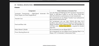

What limited slip additive is everyone using and how much are you adding with a rear axle change. I have 1 4 ounce bottle of Mopar additive left over from years ago. It says to use 2 to 5 % by weight.
Are all brands of additive the same ? Can additive bought from different sources be mixed? Should I use the old unopened bottle I have now? It is at least 10 years old.

You have to look hard to find axle grease that does not have the LSD friction modifier blended in it. I had to order some unobtanium non synthetic fluid to use in my Eaton TruTrack axle in my jeep since I couldn't anything at local parts stores that was made without it. And in a Eaton TT, you get very crappy performance from any typical fluids that come blended like that, getting the right fluid made an amazing change to where it was near locker performance. The unicorn fluid with no additive I found was called Eneos and was a VW spec fluid for use in their transmissions.
It may have additive in it, just doesn't say so on bottle. I did add a bottle of Mopar additive in it so hopefully it will be good. I think it was my '01 (not sure it could have been the '08) that after driving for about 8 hours towing pretty heavy that it started chattering in a tight slow speed turn. I added a bottle to it and never had anymore problems.
