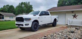

I figured I would place this here, since there isn't much discussed about a 1" option. I really only wanted to take a slight bit of the rake out of the truck. Initially, I purchased the readylift 1.75", however I decided to install the Traxda 1" spacer. I figured this is the least impactful on my stock components while I save for a Carli or Thuren full setup. Truck is sitting on 295/70/18 Kumho Road Venture MT71 tires and the truck did not come factory with the "Offroad Package". Installed about a week ago and rides well so far.

Looking good man! I like it.
@chaindriven67 Love your stance. I just ordered 295/70/18 for mine new 2020 4x4 CC. Just so i understand your post correctly. Are you running the readylift 1.75" on front and the Traxda 1" Spacer in the back or did you not install the readylift 1.75 and installed the 1" Traxda in the front instead.

Thanks, and yes I installed the 1" Traxda on the front instead of the Readylift (sorry for the confusion). I did not install a rear spacer. The front spacer is Traxda Part No. 605031, link below. I called and spoke to them before ordering to verify fitment for 2020 truck since it isn't listed.
