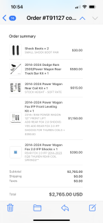

Here’s the finished product after everyone’s helpful suggestions. Thuren front: .5” leveling kit w fox shocks, sway bar links, track bar. Rear: Thuren 1” coils, fox shocks, track bar. Shock boots. Method MR315 17x37 +25. Nitto Ridge Grappler 37 x 12.5. Minor trimming. No rubbing fully flexed. Rides better than stock!
Looks great! Looking at the Thuren site and planning mine... they offer stock PW height rear or 1" lower ... did you do the 1/2" front and 1" lower rear to get that stance?
Mine measures right around 1.25" rake ... so I don't want to do the 1.5" and end up nose high... prefer to have 1/2" to 3/4" rake if I can nail it in that range and yours looks to be around that and my plan is currently just swap in the 1/2" Thuren front.
Yes. Mine is pretty much dead even front to back. No rake. After taking measurements and talking to Thuren that’s why I went w .5” up front and 1” rear.
