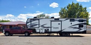

It's 36 feet long, pulls great, and I use a WDH. Took a while to set it up but now that it is, pulls like a charm. I also installed the infotainment trailer brake control kit with a little frustration and a few wrong parts sent by them, it now works flawlessly and much better than aftermarket trailer brake controls. 20230630_172304_resized.jpg20230630_172323_resized.jpg
