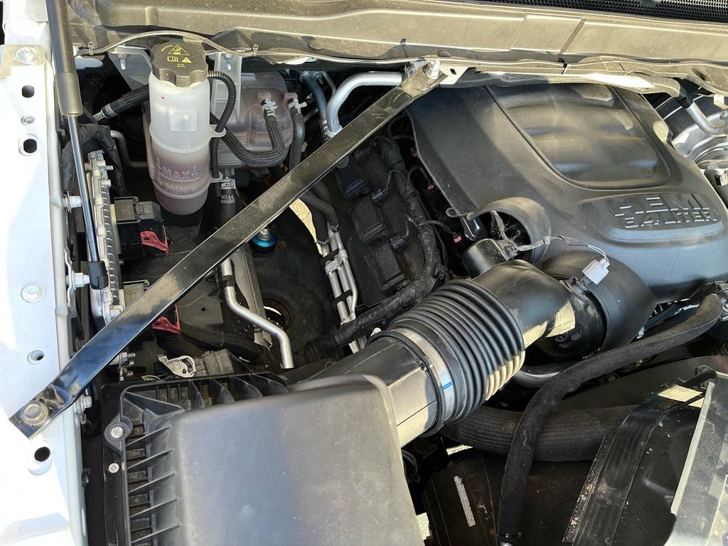

I was more worried about the airbox and the 2nd battery I have installed. Only after I ordered it did I think about if they’ll fit together. 2nd Battery, stock air box. There is about 1-2 inches between currently.F21372D6-86BD-4597-81A3-792515A93357.jpeg

I’ll try to get you a pic when I get home. You should be fine though. The new air box retains the stock air box lid, so size is close to stock.

Headed to the brothers shop this last Sunday and installed the snorkel. Fit right in next to the NH Overland second battery tray with no issues.
