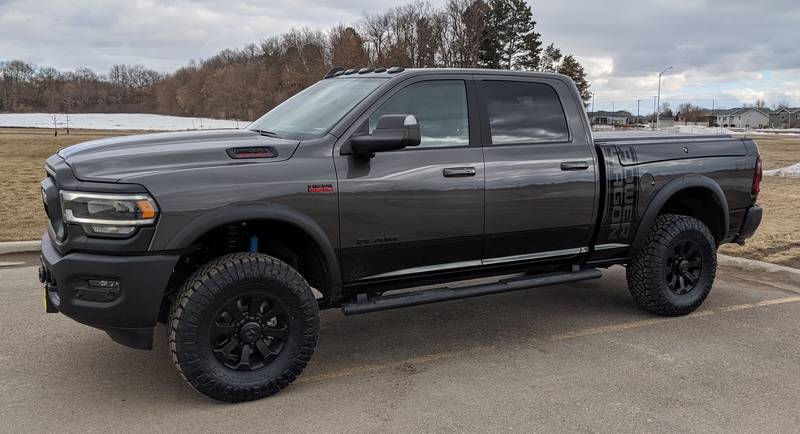

A tiny bit of rub at the back lower corners of the wheel well trim when the wheel is about 3/4 turn to full lock. I used a heat gun to move the fender liner, but need to do a tiny bit more.
Installed Thuren 1 1/2” Leveling Kit with upgraded FOX Performance Reservoir shocks and trackbar with Carli R2 2” Rear Coil with Fox 2.0 IFP shocks and new Thuren Trackbar front and rear. “Death Sway” and freeway expansion joint undulation “bouncy” now gone. Highly recommend for Power Wagon or any RAM 2500 folks.
OEM Stock 17” wheels wrapped with 35x12.50R17 Load E Toyo O/C RT Trail
hub center to wheel well measurements (with the Overlanding kit load)
Front -
Before 26”
After 27.50”
Rear
Before 26.5”
After 28.25
Front -
Before 26”
After 27.50”
Rear
Before 26.5”
After 28.25
