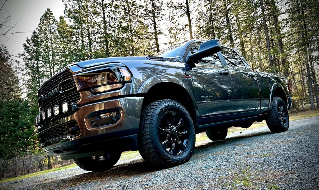

I have a grill guard on my 2022 3500. I’m considering adding additional lighting to the front end. I have space for a 22in light bar and a set of cube lights. I’ve read reviews on the Harbor freight model and the rough country black series. Both seem strong however Rough country is considerably more powerful. Any suggestions on which LED to choose?
I don’t know what your budget is but Baja designs makes a 20” bar, and cube lights, a bit more expensive than the brands you mentioned but quality is up there too.
Whatever you decide, I would not recommend any from Harbor Freight, TSC, or anything “cheap”. I have the Rough Country 30” curved back series on my truck and a 20” Blazer from TSC on my Honda Pioneer…. The cheap TSC one is garbage and already fogged up after 3 months, and isn’t nearly as bright. Compare light output and make sure you get Cree LED.

Was looking at this today. Originally was going to get 4 KC Hilites and the Randy Ellis bar that screws in next to the tow hooks, but the BD bar is about the same price total so I’m on the fence. What are your Thoughts on it, do you like it?
How hard was it to install, can you get to it without taking off the front bumper/grille. Either way I need to get a switch box, don’t have stock aux switches, only thing my Laramie doesn’t have.
