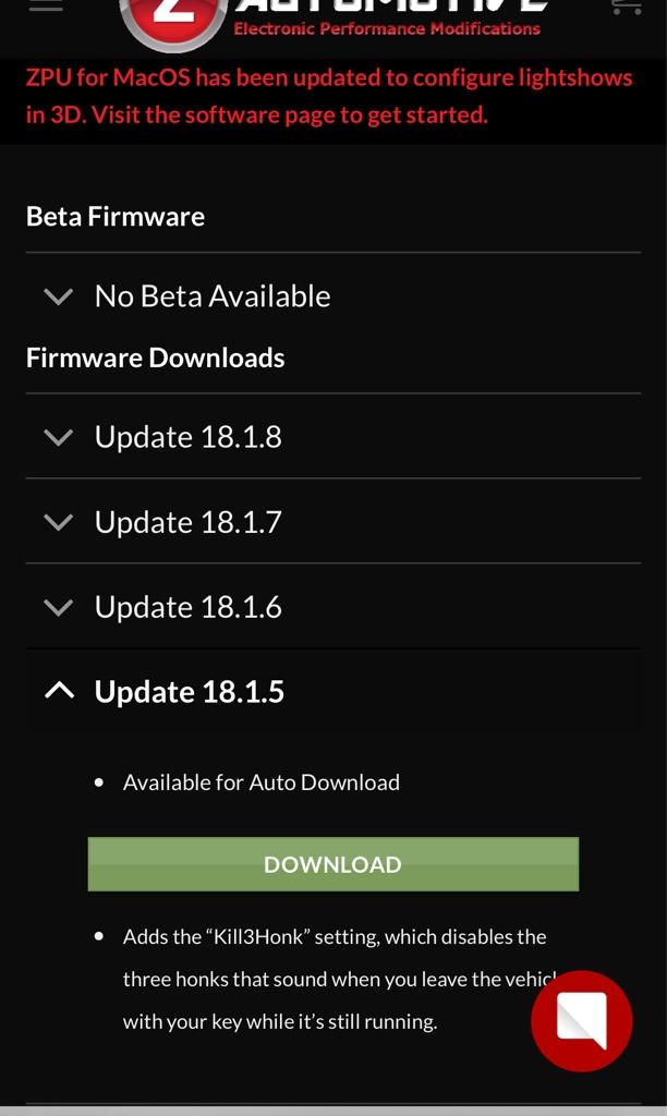

This came up in a Facebook group. Someone says that the Tazer has a “kill3honk” option.
Who has a Tazer to verify? Haven’t seen this mentioned here.
Looks like it came in a recent update.
And if Tazer can do it now, wouldn’t that mean it could be done with AlphaOBD? [mention]Jimmy07 [/mention] ?
No, AlfaOBD can only change settings that are configurable in the BCM. You connect AlfaOBD, make a change, and remove AlfaOBD, and the change in the BCM stays that way. The tazer has to remain plugged in, and the reason it’s able to defeat the feature is because it’s actively listening on the bus for that message that gets sent when the driver door is closed with fob out of the truck. As soon as it receives that message, it filters out the horn honk message that is requested.
The tazer DT is capable of killing the feature, but it is specifically for the 1500 DT ram. The tazer RAM is the model for the HD rams, and as far as I know, it doesn’t have the kill horn honk feature.
