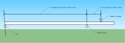

So does hanging a second trailer off the back of the 5th wheel.
And there's a simple calculation for what that is if you start with one or the other (load/no load).
* TBH, I'm no math whiz, I got this from someone a long time ago.
Pin weight reduction = load*X1/X2.
If there was 1000 lbs in the garage and the center of mass was 10 ft (X1) from the center of the tires, there would be a moment of 1000 lbs * 10 ft = 10,000 ft-lbs at the center of the tires.
If X2 was 20 ft, the pin reduction would be 10,000 ft-lbs/20 ft = 500 lbs
