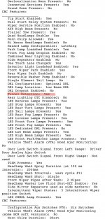

Ok, I think I found something in the BCM that might help out. I grabbed a configuration from a US market 2022 3500, and the tunnel detection is set to yes. It’s set to “NO” in my BCM. I’ll play around with it and see if that’s why we have different behaviors.
Thanks!
I'll fire up AlfaOBD tomorrow and see what it's set on my truck.
I found the Tunnel Detection in the BCM, it was ON. I turned it OFF and will see what that does...

Hmm, the Tunnel Detection setting didn't seem to do anything. At least not in regard to the headlights/dashboard/Uconnect mode.
