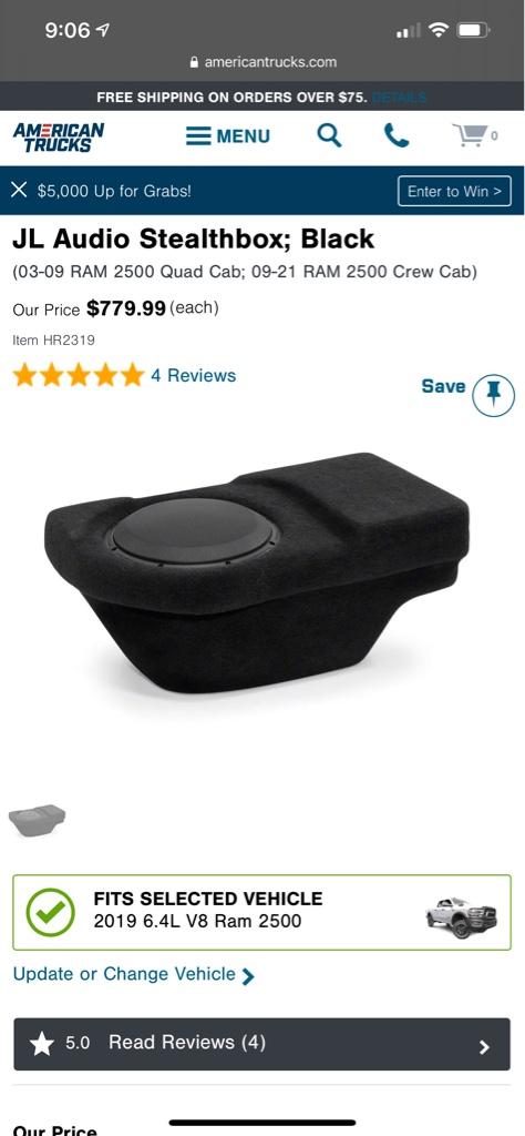

I see this sub online but not sure if anyone has bit the bullet to try it. A little pricey but I’m sure it sounds great.
I spoke with Crutcfield about a direct replacement sub and they asked me to send them measurements. I haven’t got around to it yet but I really don’t want to replace the whole box. Crutcfield sounded positive that they could figure out a sub that would be a direct replacement
