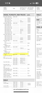

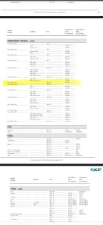

Specs seem to vary greatly. As @whitexc showed, I’ve seen the 263ftlb, and the 450ftlb both shown on his screenshot.
Not trying to say anyone is wrong but I don’t know what the correct number is. Would be nice to have the info right here for everybody to be handy
SKF shows 107ftlb for axle nut and 149ftlb for hub bolts
