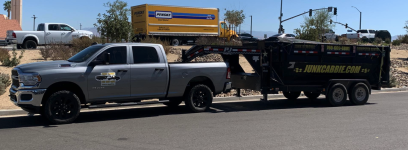

Thank you for the response! My truck is at 104K miles. I pull a gooseneck 80% of the time, very little freeway driving. Most speed I reach is 55-60 but not for more than 10-12 minutes. The light/message just flagged 12 miles ago, and I was afraid of getting stuck in limp mode while pulling a load. When I pick it up tomorrow, I will follow your advice. Thanks!Screenshot 2025-11-27 at 4.08.53 PM.png
