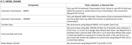

I’m at 17,000 miles now at 3 years 4 months old with 80 to 90% towing and thinking of ordering Transmission, Transfer Case and front and rear differentials oil but the quantity seems off from talking to a tech at Amsoil. (was thinking of having my mechanic do it in May or so.)
I was told that I need 7 quarts for the Trans.
2 quarts for the Transfer Case
5 quarts for the Diffs.
I watched a You Tube guy that said he used 8 quarts plus 4 ounces for his Tran.
The tech also said that the Diff oil recommended is 75W-85 but from reading here on the forum most seem to be using 75W-90. So does it matter? The tech also said 3 quarts for the front and 5 for the back
Should I be ordering more Tran fluid ?
2021 3500 Limited HO/Aisin SRW

Trans fluid wont go bad sitting in the shelf for next time so a couple extra quarts is worth getting.
You’ll need 8 quarts of trans fluid, it takes just over 7 quarts for an Aisin.
75w-85 has been recommended by Ram for a while, likely for better fuel economy. 75w-85 is also new on the Amsoil severe gear product line.
If warranty is a concern don’t forget that there are also months associated with the service intervals. 24 months for trans fluid replacement, 18 months for diff fluid (with frequent towing), and 24 months for the transfer case fluid (with frequent towing).
Forgot to mention the Amsoil tech said the Tran oil is the same oil they sell you for the Transfer Case oil, but when I talked to a dealership they say ITS NOT the same.
It’s not the same from Ram, but it is from Amsoil. I’m using Amsoil Signature Series ATF in both my Aisin and BW transfer case.
