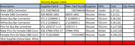

Update: Here is the wiring diagram and parts list to build the SBC
