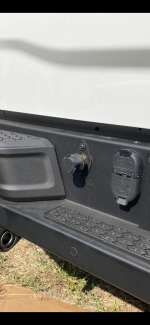

237E297D-A900-4574-8383-A7F17273BCED.jpeg0C8DBD8C-77B1-4224-BE8C-33DF8E03A493.jpegD2557F30-5E7E-4A11-A995-79E40FA4E306.jpeg3540F707-5AEC-4135-B2A5-C73FDB650866.jpeg72B24BC5-25FD-40CB-8FBB-CF462895462E.png
Yes, its a mix which is super annoying. Main connectors are 1/4 NPT the 1/8’s on the manifolds and solenoids are BSP. On the daisy chain solenoids for air bags i used bsp to npt adapters, because i found some of the quick connects on amazon were not true bsp threads.
