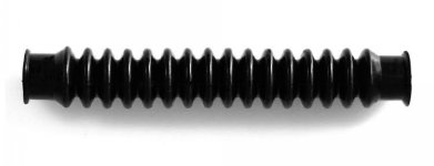

I don’t have much, but I’d be concerned with a straight run across the hinge as well. For longevity of the insulation and conductor, would it make more sense to come across the door to the hinge, drop down a few inches then continue down your yellow line (picture a “s” shape run) to the bumper mounted plug? The only reason I mention it is so it does not bind every time you open and close the door, and allows the wire to function as a “hinge”. If you notice most car doors run their wiring in a similar fashion to prevent binding.
If you do go straight across, maybe a rubber accordion style boot will suit your application well.
You could do something like they do on the Wrangler tailgate. The wires are run through that fabric strap.
I like the rubber boot and/or the fabric strap.
