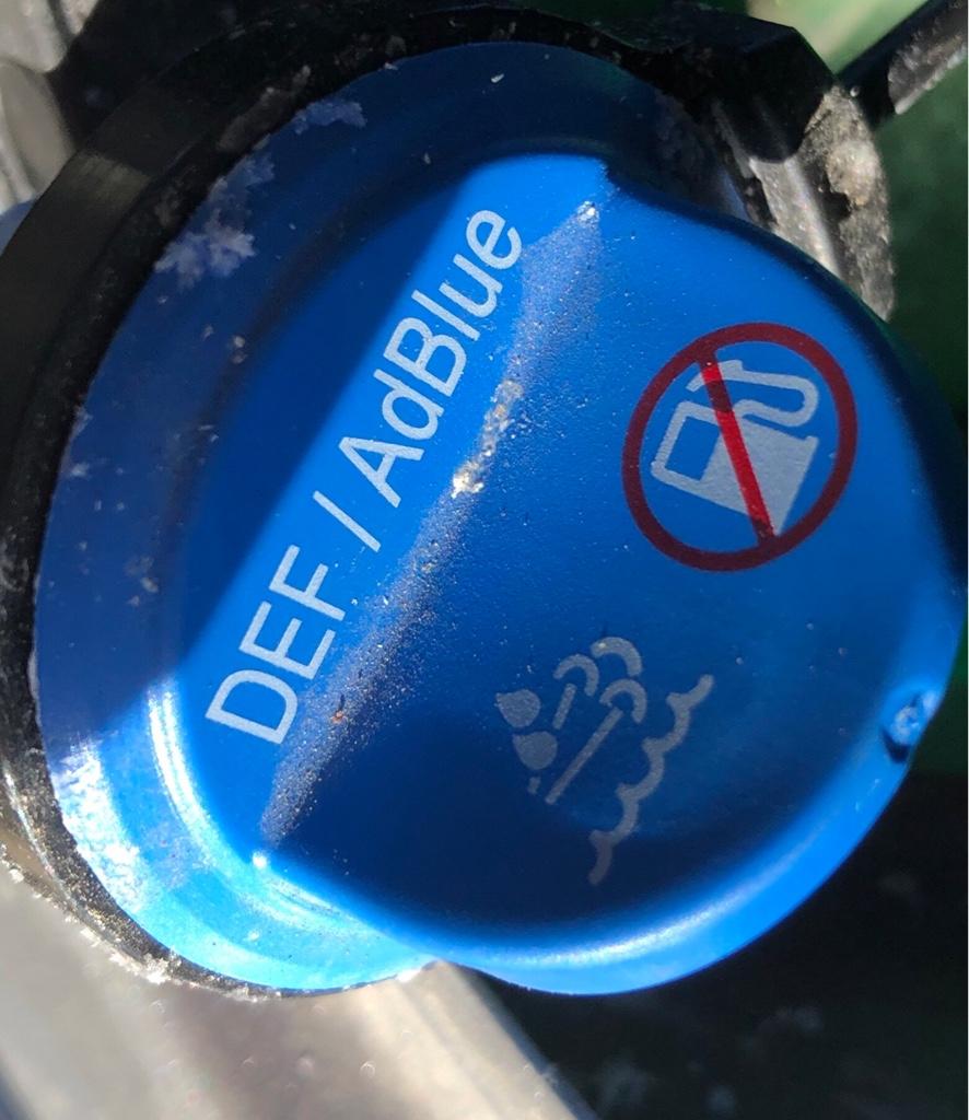

I have a ‘19 RAM2500 with Cummins diesel.
I have been having problems filling the DEF tank at gas station pumps. At least one time the tank filled properly. Other times the pump keeps clicking off and I never seem to be able to get the tank full. Today I noticed on the filler cap an icon of a fuel tank with a circle and slash through it (see photo). Are the new rams not supposed to be filled from pumps at gas stations?

Some pumps require a magnet that slides over the nozzle for the pump to function properly . I bought one on line years ago . I rarely use it anymore .
