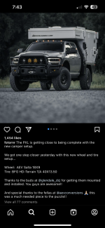

I’m in the same boat as you on the wheel search. I love AEVs +27mm as it keeps it tucked in but don’t like the 17” tire choices. AEV is coming out with a 18x9 wheel for rams but I don’t know what the offset is yet. It’s made to allow them to run BFGs 40” HD terrain and others. They said it should be released soon, but you can see it on a semi truck they had and one other build. It’s pretty similar to the Chevy 2500 ZR2 wheel.IMG_0226.png
Is this photo of the new Ram wheel? 18x9" If its 27mm or more positive offset and they are priced competitively, I'm buying!!! where can I find more info?
On AEVs instagram page this truck is running them. Also on April 17th they said the 18x9 Salta HD is coming. I called AEV about a month ago asking about release date and all they said was soon and that it’s 18x9 and will have an offset different than the current wheels. So curious what the offset is going to be.
