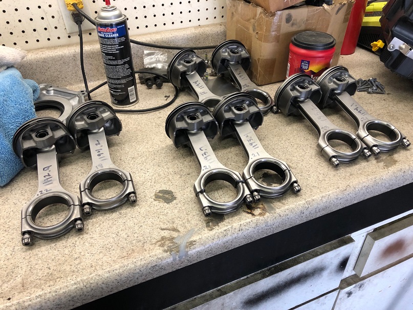

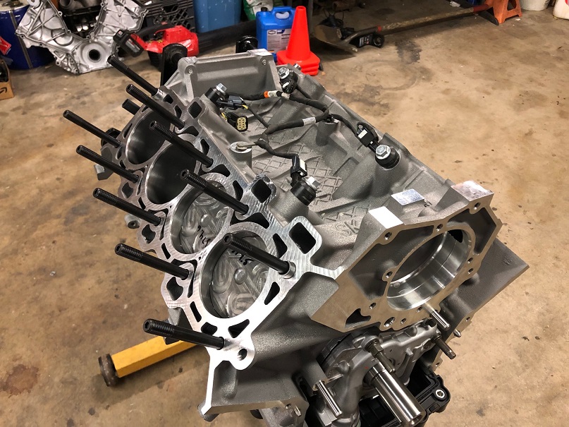

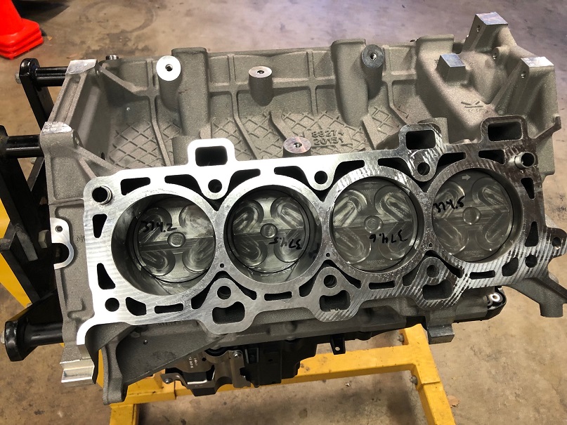

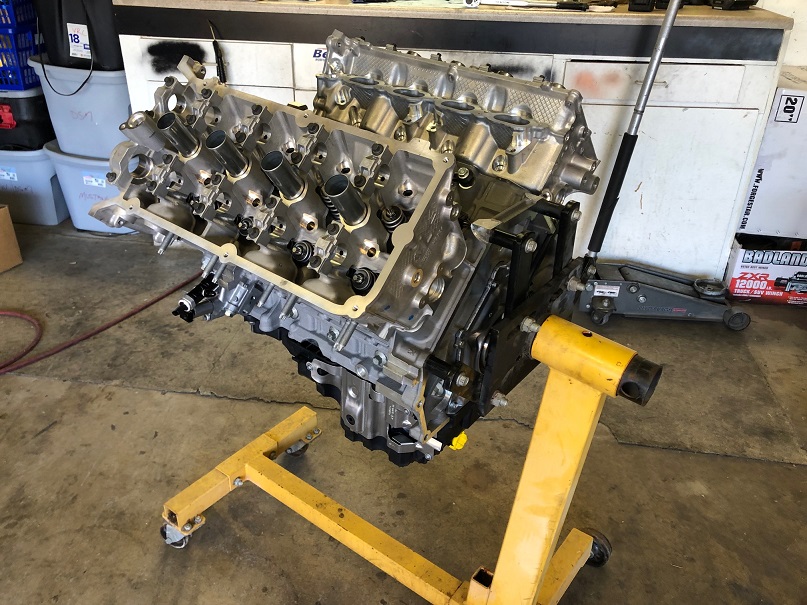

The one im building is a coyote. The basic architecture is very similar to the older mod motors. I got my hands on the factory service manual so that makes things much easier.
This motor should hold about 1200whp, although my fuel system is only good to about 1000.
