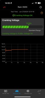

Did a search but came up empty. What is the normal cranking voltage on the diesels. I am getting around 10.8 volts on a battery monitor I have installed on the passenger side battery. Batteries are over three years old and thinking I may be wanting to replace the batteries before they crap out. I did a carbon pile load test on them and they are showing good but just inside the "good" range. Happy Canada Day on Monday to all the Canucks on this forum.
I have a battery monitor installed as well and my average cranking is 9.8v(according to the app). It starts up fine, with no sign of lugging down on the batteries. I just put in two brand new platinum agm batteries after one battery suffered an internal short. Luckily, i caught it before it smoked the other battery. Since, I've also installed a 20AH LiFePo4 battery behind the rear seats with resistor to Float the Lead acid batteries at 13.3 in between drives.
Thanks. I guess my 10.8 volts is fine then. Won’t shop for batteries for a while yet.
