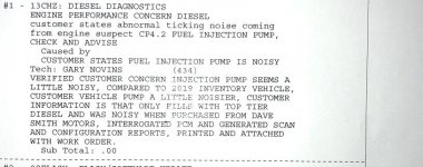

Alright I have some follow up, yesterday I stopped by a reputable Indy Powerstroke shop in my area to listen to my CP4.2 pump since Ford has been using these for a while, after listening to mine for a few he tells me to take it back and it should not sound like that. He tells me what it will do is start to throw codes for low fuel rail pressure and may or may not just quit working or just start sounding even worse. Today I get it back into the dealer that had to do a bunch of work on my 2019 1500 and it was in the shop close to 50 days in 1 year and I had had enough with it and Ram would not put me in a new truck so I bought the 2500.
After having the service manager look at it and listening to the ticking rattle along with extra intermittent rattle he brings it to his Diesel master tech and he listens to it, of course the first thing that comes out is bad Diesel fuel with 2300 miles and I tell them I have been buying top tier Diesel from Costco or Chevron and I have receipts except for what Dave Smith Motors put in so that's out the window. They bring in a brand new 2019 2500 off the lot and park it behind mine and compare and determine mine is making a ticking noise not heard in the new 2019 2500 on the lot. They document that it has been making this noise since new and are going to bring in the area service tech that specializes in stuff like this to determine what to do next with my truck.
If they try to put this down to bad Diesel fuel and not covered under warranty I'm done with Diesels if you can't buy Diesel fuel anywhere and drive more than 2k miles on a engine that should outlast the truck. What's the point of having 2 2 micron fuel filters for if contaminants are going to kill the CP4.2 pump in that amount of time. I'm not sure if you all know but to replace the complete fuel system after a CP4 pump failure is around 10k.

Alright, I had my appointment today to have my CP4 pump looked at and after having the Team Service manager listen to another 2020 2500 that was quiet as a cucumber with the hood open and mine you could hear from over 10 feet away rattling away that we both confirmed. The 4 different techs at the dealership claimed it is (Normal) wow what a surprise, they claim some are louder than others, but when is a high pressure fuel injection pump supposed to be louder than a Diesel engine. While in park if you give it a little bit of gas it has a weird rattle on deceleration back to idle like its has a air pocket in the system. I guess now when it blows up Ram Is going to be on the hook for what ever damage this pump does and I tried being pro active on this.
I say if your pump sounds anything like mine I would at least take it in and get it documented so when it does fail you are not to be blamed for bad diesel and be put on the hook for the cost of repair
Something caught my eye when looking at the printout the dealer gave you. You said they confirmed your pump was louder. They snuck a line in the report that says, “Listened to another new 6.7L and the noise was similar.” Seems kind of shady that they’re putting on paper that there was no difference. Just wanted to make sure you noticed that discrepancy.
