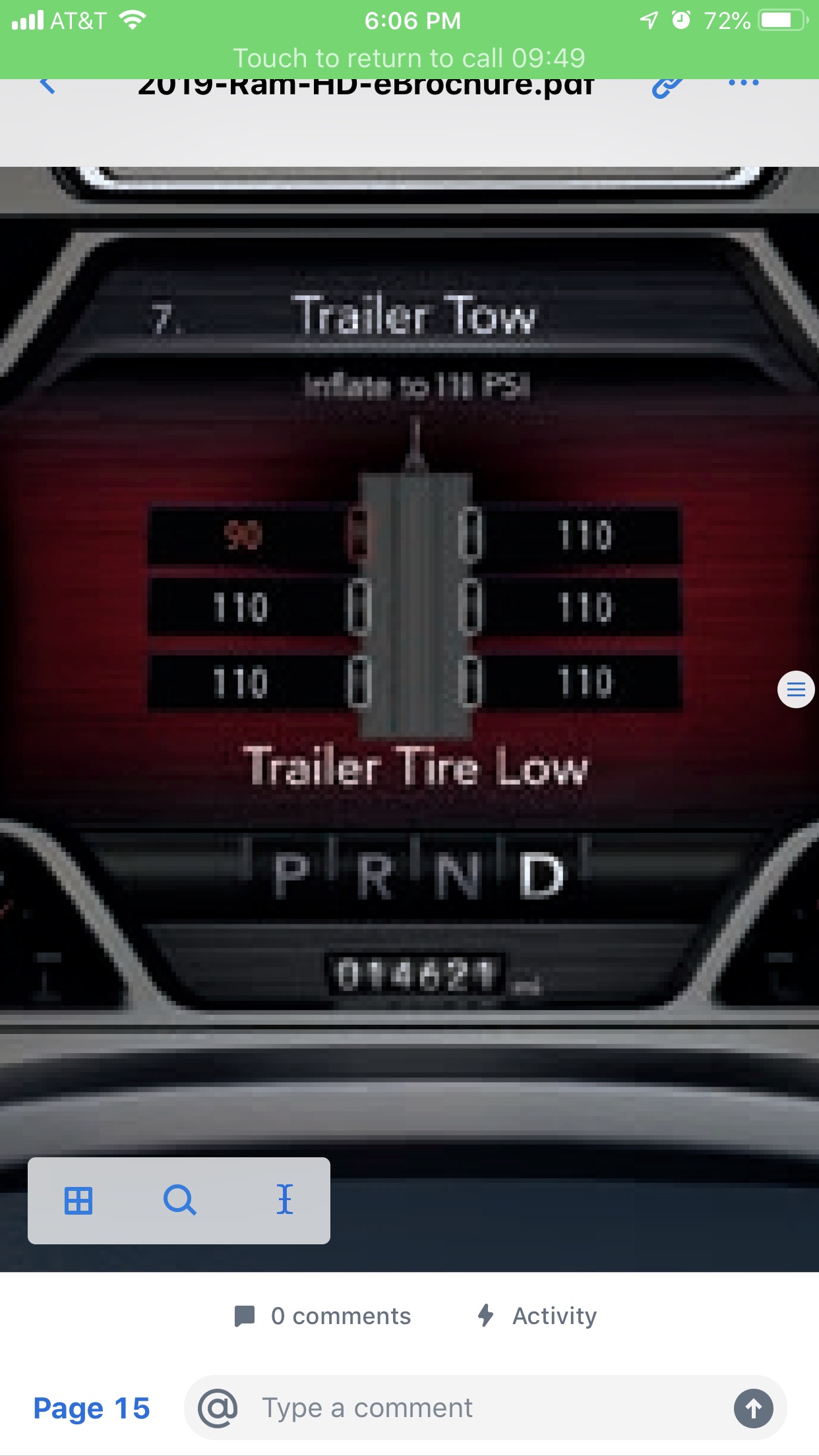

Thanks. I guess we all just need to keep our fingers crossed on the trailer TPMS now.
Still holding onto this feature to use. Was one of the reasons I traded up from 2016 to 2019 plus crazy camera system and huge navigation screen. My sales person even pointed it out in brochure he gave me. Still keeping it til I get it.
It is supposed to be on it but not till late 2020. Here is what RamCare chat sent me and I have a 2020 limited all options on order. Still D1 status

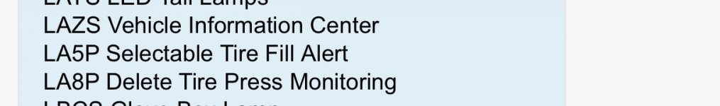

Here’s what RamCare sent me it shows dltd and I didn’t delete and I have the OMG that is supposed to have it

@Klinger was agreeing with you. My build sheet shows the same delete but are saying that you're getting it?
All 3500 are delete monitoring and add tire information. So no alarms go off when aired down for comfort.
I just wish it had trailer tire pressure as I tow. These trucks are meant for towing

If you ordered the aux camera, there's still hope the TTPMS upgrade will be an easy addon, even if it's owner assembled.
So far, there are 3 parts identified as needed besides the sensors themselves. The TIM in the headliner, a bumper mount receiver, adn a pigtail cable for the TIM. The only thing we're waiting on is the pigtail PN and availability. If necessary, one can be built.
With XFQ trailer camera wiring present
The kit for the TPMS sensors for trailer wheels is 68433188AA
TTPMS bumper receiver: 68375990AC
TIM headliner module: 68404893AB
TIM pigtail: currently unknown
