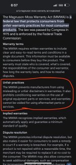

That's total BS !! As long as an aftermarket manufacture declares that their filter is compliant with minimum filtration requirements you are fine . They have to prove the filter you used was the problem . They just can't deny your warranty . People use different filters whether air ,oil or fuel . Read your warranty closely to see if there are any clauses in it . Thousands of cars and trucks run STP filters without a problem . Haul their ass into court . Let them explain their deniability to a Judge , that should be fun to watch .
You need to escalate this to Ram cares and the dealer service manager. This is a violation of federal law. No tractions, you need to sue in small claims court based on the estimate
