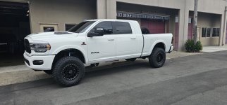

has anyone ever had any problems with there carli 3.25 pintop kit? I had a dealership install my carli 3.25 pintop kit. The problem I'm having is when hitting those water drainways in random parking lots or similar dips, potholes on the roads, im getting a metal to metal hitting. This kit is really smooth and soaks everything up that has upwards bumps. But when hitting something that goes downwards like those water drain ways, something is hitting metal to metal. At least that's what it feels like. I thought maybe my wheels were loose. They were not. I checked to make sure the top steering stabilizer wasn't hitting. It was not. I called carli and asked for their input. They told me to torque everything down and make sure the wobble stopper is on the back side of the Trac bar. So I rechecked and torqued everything down and the wobble stopper was in the right place. And it's still doing the same thing. It's only on those downward dip and potholes. It's not making a loud noise of metal hitting. But definitely can feel something hitting almost like metal to metal slipping against each other. Has anyone had any issues like this? And what was the fix. Thank you in advance.
