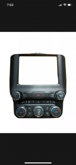

I was looking at implementing this feature and as I was poking around under the console, I came across a plug that seems like it may be the temperature sensor plug!
I have a '22 Tradesman, 8.4 non NAV, standard climate knobs.
The plug was paper taped up to another harness so, when I went to pull at it to see it's length, it came right down, plenty long.

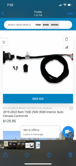

The plug & wiring matches this,
Here
first pic is looking up behind the center from drivers footwell... Thoughts?

Sun sensor is 68230115AB so, guessing the 68230114AB is still needed?
