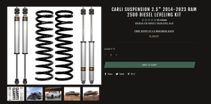

I am looking at purchasing a leveling kit for my 2022 Ram 2500 from CJC Offroad and I am currently between two kits.
There is a lot of love for the Carli Suspension 2.5" and it comes with:
- front springs
- front and rear Carli shocks
The price for this is $1260.
My other option is the Bilsiten 5100 2.5" kit which comes with:
- front spring
- front and rear Bilstein shocks
- Carli track bar
The price for this is $1325.
So my question is, for around the same price, the Bilstein kit gives you an added track bar. You can add the track bar on the Carli kit but you would be closer to $2000. For the price, do you think there would be a noticeable ride difference between these two specs?
Thanks!
I never rode in the new Carli spec’d entry system, but I imagine the custome valving may be noticed over the generic Bilstein 5100’s. I would also look at Thuren Trac Bar if adding one.
I would take a peek at Thuren leveling with coils, shocks, trac bar as an alternative above.

Oh wow, thats a good valid 3rd option. Thanks for the input!
I don't know of anyone running the in-house made Carli shocks to give them a comparison to Bilstein or Fox 2.0's, but they look like they could be promising. I'd prolly wait until there's more data around longevity between needing replacement/rebuild, etc before saying anything positive or negative about their new shocks. That said comparing basic Fox 2.0s against 5100's - 5100's usually get my vote from a cost perspective. 5100's just run until they blow and replace like any other shock. 2.0s you can rebuild, but it can be a bit pricey if you don't do it yourself and in some cases its cheaper to replace.
There are several good resources comparing 5100s to Fox 2.0 IFP's but the basic comparison is that 5100s will be firmer on the initial hit where as Fox 2.0s will be a tad softer until you push more shaft speed. This comes down to most Fox 2.0s being progressive or close to linear valving while 5100's are digressively valved.
