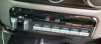

#38 and #42 appear to have the same marks.I don't see that this was posted anywhere, and it's always best to find a truck VIN with AUX matching your other features, but this AUX switch decoder chart was seen on the sister site 5thgenrams. I don't know the true source, use at your own risk.
I think #42 is correct and #38 should be on traction control and not on Exhaust brake.
Them Mopar graphics are so poor I ordered #38 and assumed it was the one I needed according to the chart.
elephantrider posted a picture of what it suppose to be. He knows the proper part#.It appears so. I didn't make the chart, just found it online.
Good info if you have something that shows the panel, I can make note of it.
