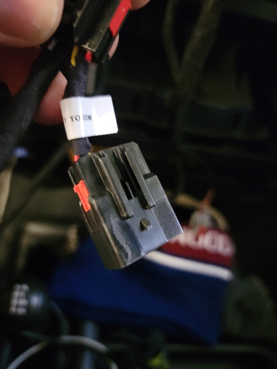

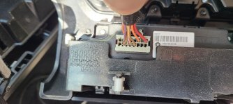

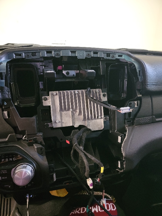

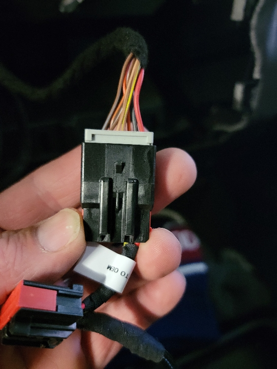

Here are some pics of the wire loom install thar PaulVI supplied to enable your own Aux PDC.
Nothing exciting about the pics but super simple install.![]()

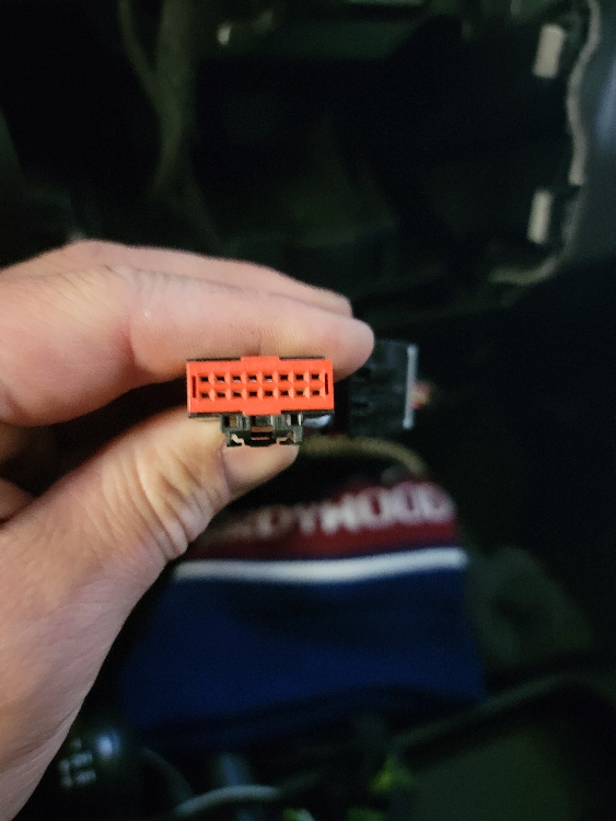

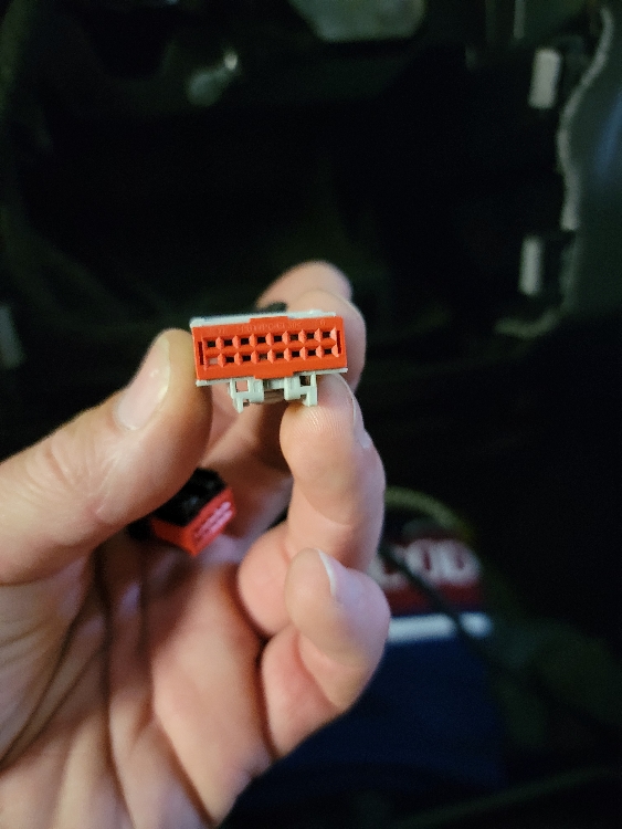

I have read the thread and I THINK I have a handle on it. I will be adding Aux panel 68376642AE to my 2019 3500 Tradesman HO. If I do this, and activate it via AlfaObd, I still need to add wires to the back of the connector correct? (Pic attached) If I need to add wires, does anyone have part numbers for the crimps?
The wires ground, which I will attach to my own Aux relay panel.
Thanks Guys!! Awesome Forum!
The six wires are in that connector (they are on every single truck), BUT, the other ends of them stop at the XY125 connector, and do not continue to the left dash harness into the engine bay. It’s hard to source the the terminals for the XY125 connector without having to buy 100 of them, so the simplest thing you can do is de-pin this cluster of six wires from the switch bank connector, and use these terminals to crimp onto six new wires of any length you choose, insert them into those positions on the switch connector, and run them wherever you want- https://www.mouser.com/ProductDetai...zmoIuWKhqPFeWI5hXQapUY7BrjWb&tetid=72GIXGTFGMHey Guys! I was directed to this thread from another by Brutal.

That makes me cringe because I always do everything possible to avoid cutting factory wiring, but yes, if that’s what you want to do, it’ll work.That's great info Jimmy07. Thanks! Presumably, I could simply cut these wires after say, 6 inches, and butt connect them to wires I extend to a relay-box right? I think I'm understanding this correctly. Thanks again for the help!
Or just message PaulVI and pick up the connector from him. Best way to do it IMHO.That's great info Jimmy07. Thanks! Presumably, I could simply cut these wires after say, 6 inches, and butt connect them to wires I extend to a relay-box right? I think I'm understanding this correctly. Thanks again for the help!
