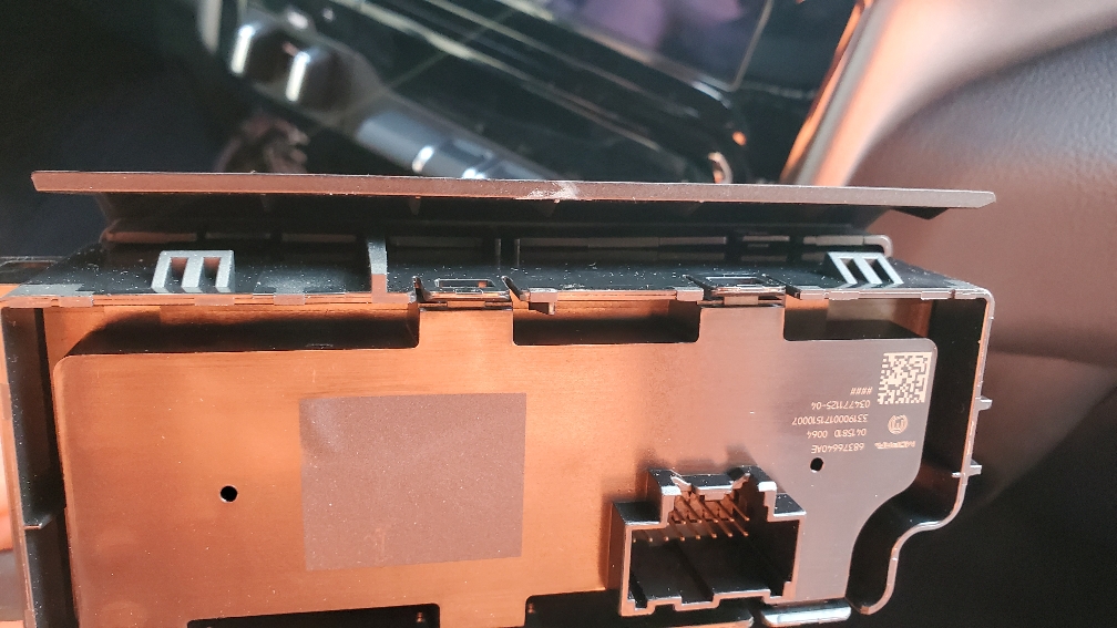

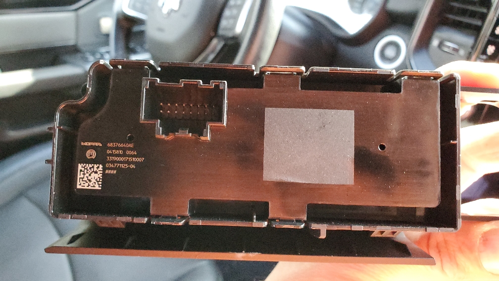

Here are pictures of the switch. While you can pull off the faceplate it doesn't look like you can replace the writing on them unless you get someone to mold you a custom button

One more question, did the original switch panel connector plug right into the 68376640AE aux switch panel? How many wires go into the plug, does it seem like there are enough in that connector to run 6 aux circuits in the aux PDC?
Do you have a picture of the back of the original non aux switch panel?
It is the stock connector. I thought the same thing as you but there are enough given it isn't driving 12V power to each but rather a bus signal.
