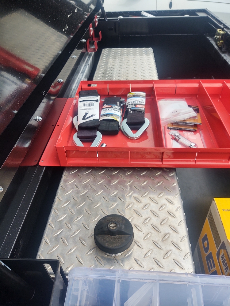

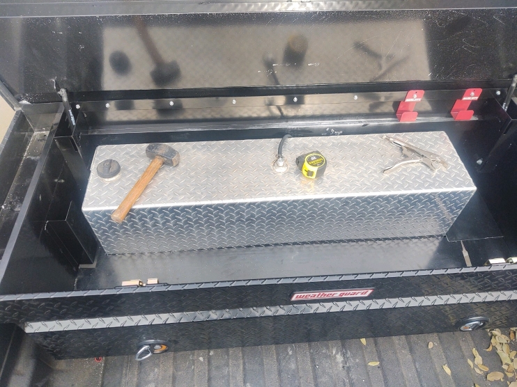

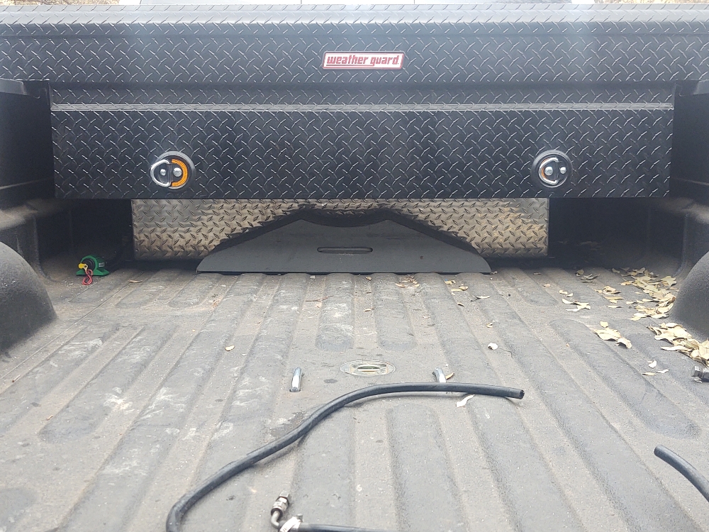

Here's my set up. ATI 41 gallon tank with a 38gph pump wired to an aux switch. 91 gallons.
EDIT: this is the third truck I've rigged like this. Keeps thieves and nosey highway patrol at bay... LOL
