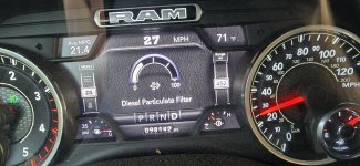

Was running the Fleetgaurd with orange foam and correct part number. However, it seemed a bit yellow so recently changed over to a Mopar from Geno's. The truck did seem to like the Mopar one better at first, regenning passively fairly easy around surface streets, but then taking it out on the highway all the old problems popped up again. Going from 30% DPF full to 70-80% DPF full in a few miles for example.

As of today ive put about 200 miles on archoil, fuel milage seems up a not quite a mile per gallon. im currently sitting around 700 miles (11 hrs) since last regen, but the % hasnt gone up.
