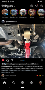

Looks like he finished up. I think it's one of the new 3.0 Johnny joints at the frame. Bung is welded in nice. Pretty slick for very little money.
Johnny joints don't transfer vibration to the cab. That's marketing BS. They also require nearly no maintenance.

I saw this on Instagram... Pretty cool. This guy replaced the frame side articulink bushing with a 3.0 joint. Less slop, but still maintains flex, since all the magic happens at the axle anyways.
I've thought about doing this in the past. From my tests, I wasn't getting bind at the rearward joint. (80 series Land Cruiser guys used to to this as well. They would either replace the rear joint with a spherical bushing like this or add a joint to allow for longitudinal rotation.) In my Land Cruiser experience, though, this joint didn't really provide extra performance. The bind in the radius arms came in the axle side joints. Now, I know that the articulink already addresses axle side bind with the added joint. But, I'm curious to see where the bind in a stock articulink really happens... and if it really fully binds at all. Do you know what springs and shocks this rig is using? I'm wondering if he is trying to do a version of a long travel suspension on stock-like radius arms. (which I think is a cool idea) Maybe if you are trying to run 14" travel shocks on radius arms, I could see this really coming into play. Keep this thread updated as this thing gets tested!
