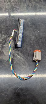

And so it begins. Got a few amber surface mounts (feniex fusion s)and added a connector to the end. Waiting on a few more to come in along with the wiring so I can build the harness. Should be a fun project. Hope I can get it done before hurricane season starts.
