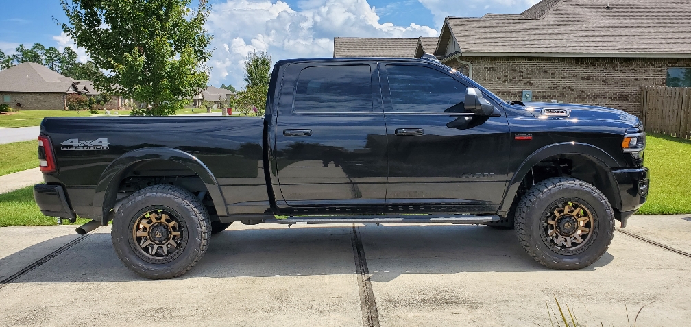

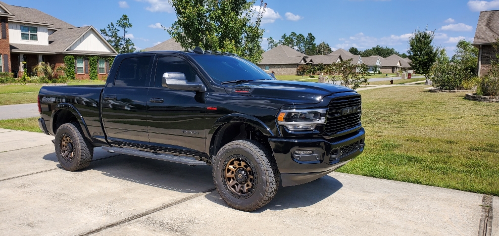

Here is mine. 2.3" bilstein level in front, 1" spacer in rear to bring a little bit of the rake back. 305/70-18 tires, 18x9 +18 offset wheels.
Did the 2.3" Bilstein level your mega cab? Reading the Thuren tech info it says to use their 2.75" for the mega cab since it is heavier then the regular crew cab. I'm so confused!
Pretty much. It was too level for me so I added a 1" spacer in the rear. Yes the mega is a couple hundred pounds heavier but it's not a lot. Also the weight is some what rear biased. 2.75 will level it but it will appear nose high due to the lines of the truck in my opinion.
