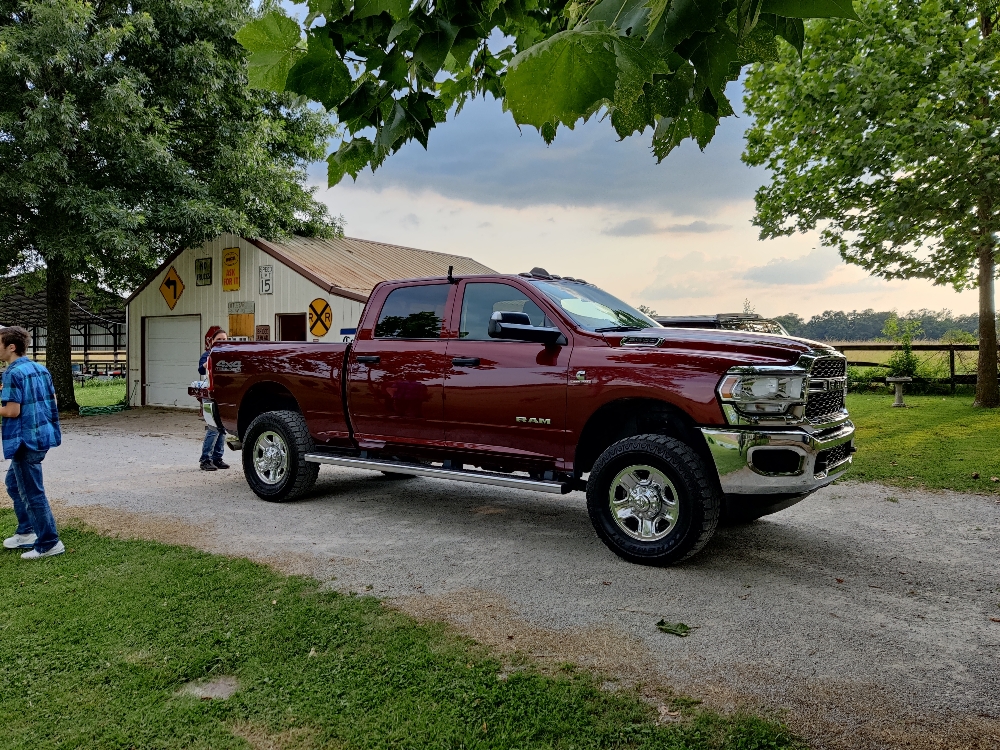

I've got a mount for my 70cm/2m NMO that clamps to the to edge of my back door. Amazon special that actually works and holds up well. Zoom in and you'll see the antenna near the b pillar

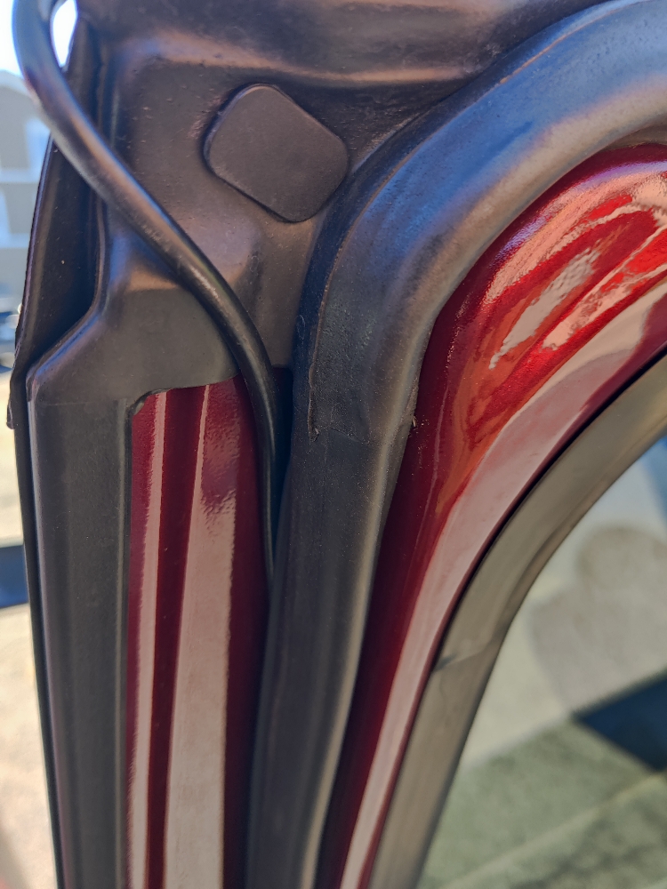

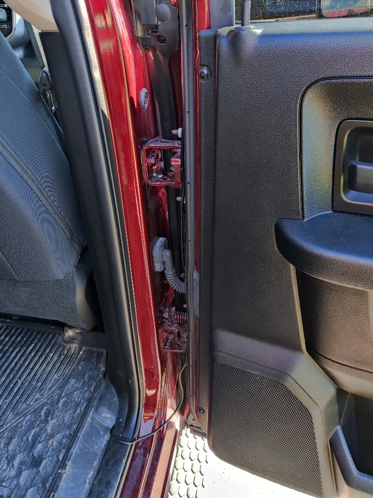

I'll try to remember tomorrow. The wire actually runs nicely and stays tucked away. Nothing hanging out exposed when the door is open

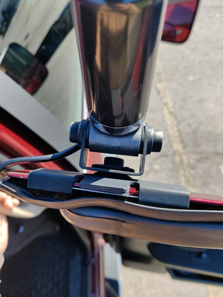

The wire trucks in nicely behind the weather strip. There are four small set screws that hold the mount to the door edge(aluminum plate between the screw and the paint for a bit of protection.
