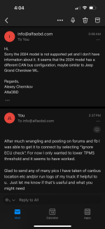

FWIW I heard back from AlfaOBD
I made change to TPMS threshold and it stuck. But thought I’d share this message:
