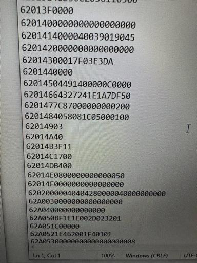

If you look at your current backup file, what does it show for line item that begins with 62014A? Is it CC?
Does it show 4C on your original backup file?

That’s the original back up I made before making any changes. Other than heated wheel I didn’t touch the seats A.
This is from the original file. Only thing changes was splash screen when I downloaded this info
Current “Heated Wheel” is set to “default” since there isn’t a “Not Defined” option available. I think I saw in another post somewhere you had mentioned that but I saw it too late.

In that original backup file, take line item 62014A40 and move it to the top of the list, and try restoring it that way.
Just want to make sure so that I don’t accidentally brick my truck lol. Like this? 27F46177-AFF2-4692-B62A-37D852E5A4B0.jpeg
Cut it from where it was to the top and then closed the gap from where it was cut from
Yeah, like that
